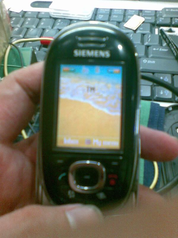

Benq siemens SL75 auto off revived by dreambox

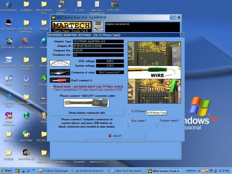

this one is different testpoint position inside flashchip need to modified the pin to connect tp properly ( you can flash /unlock sl75 without tp if this bootcore erased but this one is not )
try in martech it always error 00.15 although tp is correct so now i decided other box and my dream fullfilled by dreambox

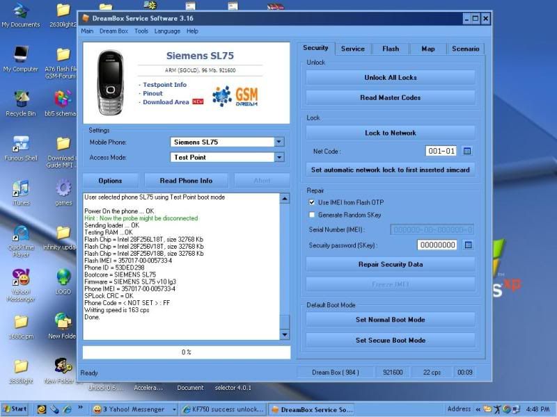

connect dreambox
insert cable data and tp
dissamble the phone
read phone when phone detected

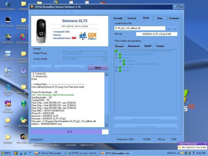

fullflash the phone
repair imei
and lastly unlock
viola...
thanks to my good friend CHINAMAN for the good flashfiles
