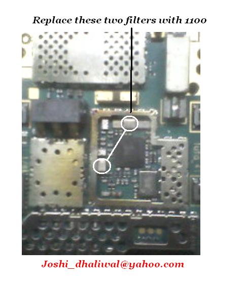

:)Nokia 6103b to 6103 convert:)
1.Unlock mobile on jaf or ufs simply
2.Replace two filters with 1100 or 3100
3.write good pm..u can write of 6101 also
4.unlock onace again & enjoy all operaters

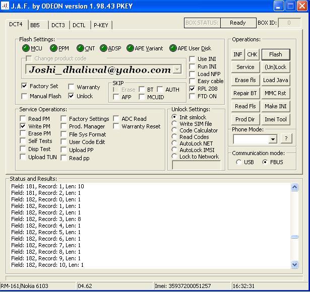

here is pm files-- 6101 & 6103 pm files.rar
here is screen shots---
Backing up PM Field 208 as RPL...
Setting local mode...
Reading IMEI...
Reading IMEI data...
Building RPL backup file...
C:\Program Files\ODEON\JAF\ProgData\359372000512574_imei_backup_163132.rpl
Done!
Backup imei OK!
Flashing Done!
Operation took 0 minutes 2 seconds...
After flash processing...
Waiting for phone to boot...
Reading...
Phone type: RM-161, Software version: 04.62
IMEI: 359372000512574
Product Code: 0522987
Resetting PPC...
Setting FULL FACTORY......Setting test mode...
Operation took 0 minutes 9 seconds...
Done!
Done!
Powering the phone...
Unlocking...
ASIC: 2
SW version: 04.62
Checking locks...
Block 1:
Lock 1: OPEN Lock 2: OPEN Lock 3: OPEN Lock 4: OPEN Lock 5: OPEN
Block 2:
Block 3:
Block 4:
Block 5:
Block 6:
Block 7:
Done!
DCT4 unlock counter: 235
Done!

maybe it can be make some jumpers of the
filters if you have no filter available!!!
br..
