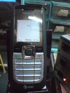

1. Check firmware version , if it.s 4.70. If so, just flash unit with rh-86 fw 4.90 mcu,ppm,cnt. Write good pm file.
2. after flashing unlock unit. Then do hardware modifications. Change 2 filters.
Flash file + pm file here: http://www.mediafire.com/?yttlcth2wzq

Phone type: RH-87, Software version: 04.90
IMEI: 011191003736869

Unlock
30:04:2008  17:12 -> Powering the phone...
30:04:2008  17:12 -> Unlocking...
30:04:2008  17:12 -> IMEI: 011191003736869
30:04:2008  17:12 -> ASIC: b
30:04:2008  17:12 -> SW version: 04.90
30:04:2008  17:12 -> Selected flash file: C:\Program Files\Nokia\Phoenix\Products\RH-86\rh86_87__04.90.mcusw
Decrypting flash...
30:04:2008  17:12 -> Encrypting....
30:04:2008  17:12 -> CHK Patch found - Unlock Patch found and are not in same block
30:04:2008  17:12 -> Patch status: 01
30:04:2008  17:12 ->
MCU ID: 0x3040
30:04:2008  17:12 -> Algo is ready...
30:04:2008  17:12 -> P-key nokia module version 01.01
30:04:2008  17:12 -> Erasing area: 010A0000 - 010BFFFF...
30:04:2008  17:12 -> Checking locks...
30:04:2008  17:12 ->
Block 1:
30:04:2008  17:12 -> Lock 1: OPEN 30:04:2008  17:12 -> Lock 2: OPEN 30:04:2008  17:12 -> Lock 3: OPEN 30:04:2008  17:12 -> Lock 4: OPEN 30:04:2008  17:12 -> Lock 5: OPEN 30:04:2008  17:12 ->
Block 2:
Block 3:
Block 4:
Block 5:
Block 6:
Block 7:
2610b at&t 4.70 ver. imei 01xxxxxxxxxxx convert success
