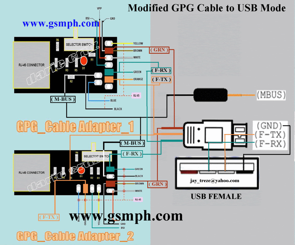

This is my gpg cable was modified by me and it's working 100% properly!!
Instruction how to work :
1. Connect the usb cable to phone usb .
2. Connect properly the VBAT GNR & BSI.
3. Find the MBUS Pin to the phone and connect the black needle  in MBUS .
4. Then insert the GPG Rj45 cable.
Notice:
[B]You can also use this Universal 7-PIN cable for FULL FLASHING a phone
But you need to connect BOTH MBUS and RX2 to the phone when the
"Writing Flash" begins. During "Erase Flash", only the MBUS is needed, so
it gives you a few seconds to properly connect the RX2 after using your
other hand to click the "FLASH" button on the software.[/B]
SCHEMATIC DIAGRAM
Mbus Locate At Pin #2
GPG PIN OUT ( HELPS TO FIND YOU THE MBUS )
In GPG cable you can locate the MBUS Pin #7 of 6500c 6500s 6300 n80 Etc!!
