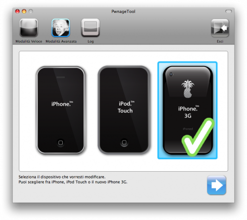

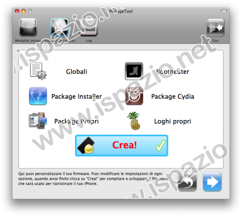

2. Click on second icon “Advanced” then select your device; next arrow.

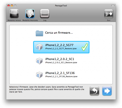

3. Software will look for the original firmware 2.2 on your pc: if you have more than one pay attention to select the 2.2, next arrow.

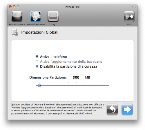

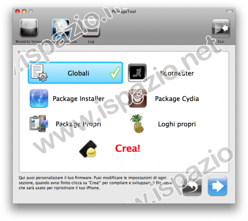

4. Click on “Global” and start with custom:
5. "Activate Phone" and "Disable security partition" then next arrow.

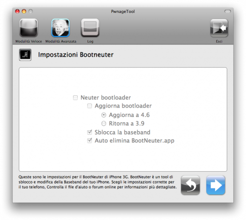

6. This page is enabled only with iPhone EDGE so, next arrow.

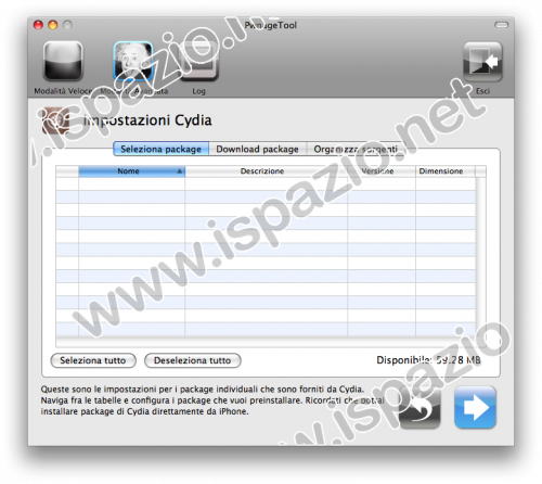

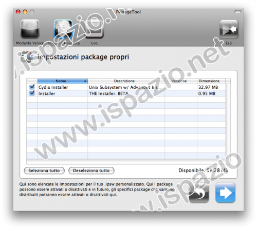

7. In this page you can add a repository in Cydia so you can install all applications you prefer. Enter in “Manage Source” and add repository you want. Our is:
http://cydia.ispazio.net
but you can find the others in our
Sources
web page. Enter now in “Download Package”, refresh and select all the app you want on your mobile, then click on Add To Queue; next arrow.
8. In the installer we can't add repository and so include custom packages into the firmware: continue with next arrow until you'll see the screen with your selection as above.

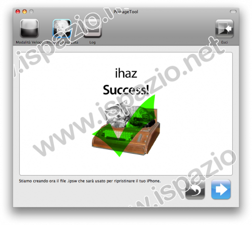

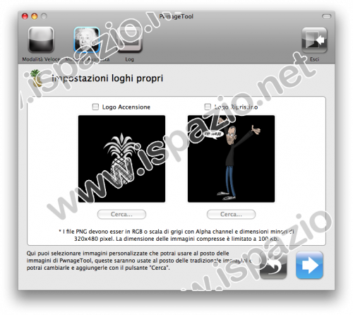

9. Deselect “Boot logo” and “Restore Logo”, if you want the original ones from Apple, or choose what you want clickin “Find”; next arrow.

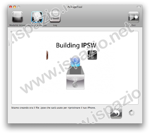

10. Create! in red: choose a folder to save the custom firmware that will have a name like: 2.2_5G77_Custom.ipsw then “Save”

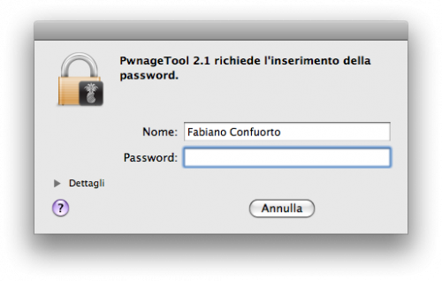

11. Process will take some minutes, then Mac will ask for the admin password.

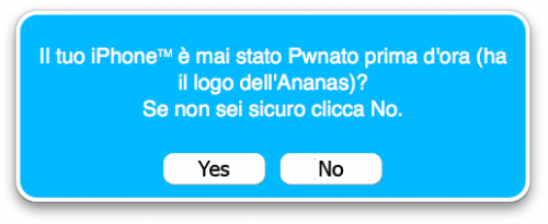

A window will ask if your iPhone has never been Pwned: if not sure click NO

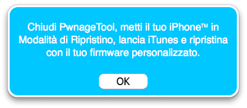

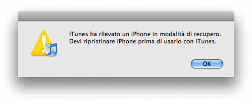

12. You will be prompted to go in DFU mode.
PwnageTool will detect iPhone in correct DFU mode and will ask to be closed and to restore the custom FW from iTunes.

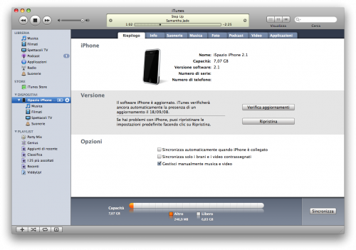

15: Open iTunes that will ask to restore your iPhone:
16. Click OK then ALT + Restore in iTunes.
17. In the next window you'll have to choose the 2.2 custom FW. iTunes will verify it, and then restore on your iPhone.
