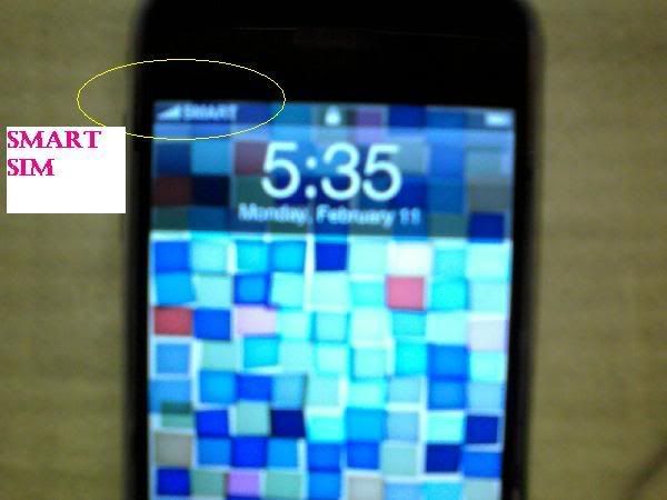

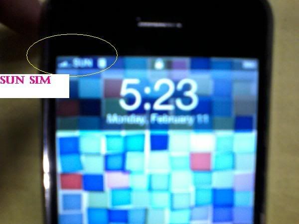

« Reply #6 on: February 11, 2008, 03:12:28 PM »
Unlock without using any turbosim now!!!
